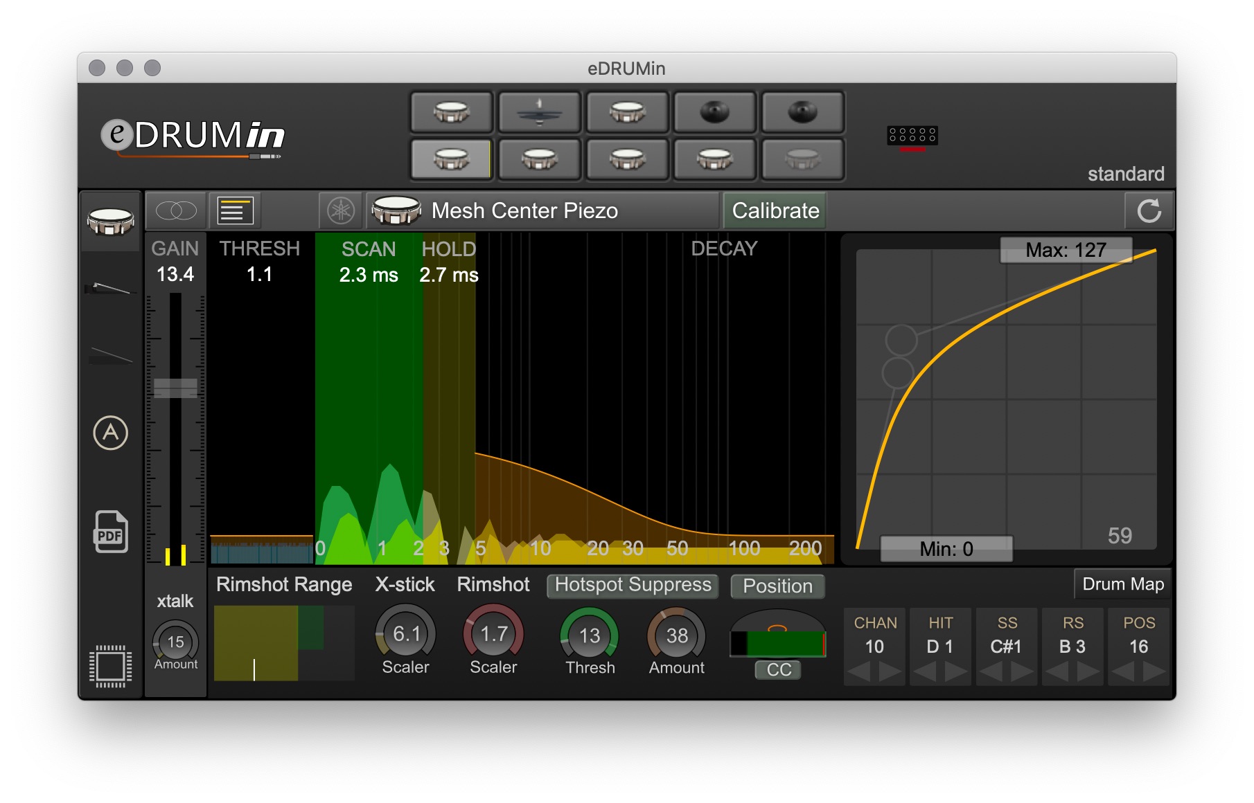

Thanks for the great product. I've dug in over the past few days and have it setup with EZDrummer.
I'm having some difficulty with the snare drum (PD-125). I can't seem to get low velocity ghost notes and the low vels trigger a cross stick each time. I played around quite a bit with the 3-zone adjustment and the threshold. I can only get it so that the ghost notes trigger the snare ONLY but then it's insensitive to x-stick. I can't really get a good quite roll or pressed roll or shuffle (Purdie style) ghost notes in there.
I used the PD-125BK preset. Not sure if that's the right one as my Snare only says "PD-125" (no BK).
Also - the side of off center zones of the mesh head trigger x-stick too... any suggestions? Screenshot attached.
Also, what is the best way to save my entire bank for backup? Do I have to export each pad preset individually?
Thanks.

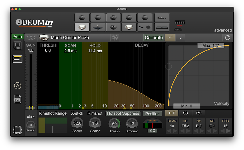

I have a PD-125 as well (the BK is just a color code, mine is the WT) and I have no issues getting ghost notes. Just looking at your screenshot, I would start by making the Scan time longer (until where it dips after those first three peaks) and definitely make the Hold a lot longer (10 to 15ms).
As for the edge of the head triggering rim hits, I've noticed that too and posted about it. This may or may not be PD-125 specific, but one thing you can do is adjust the Rimshot Range control by making the left (olive green) box a lot narrower. That's basically where the cutoff between head and rim happens and it can be very finicky.
Below is a screenshot with my settings. I've also attached a preset if you want to try that out.
Screen Shot 2021-06-18 at 11.57.21 AM.png (371.06 KiB) Viewed 1255 times
Roland_PD125.edp.zip
(712 Bytes) Downloaded 154 times

The issue with your setting is that your GAIN is far too high, and your HOLD is far too low. After you sort those out, then you'll want to take a look at your RIMSHOT RANGE control.
Thanks a lot for that! It works much better now with those settings, although I'm still really not able to get the most sensitive, repetitive notes, like a pressed roll at low dynamics... a crosstick still comes out. maybe it's just the pd-125 though?
