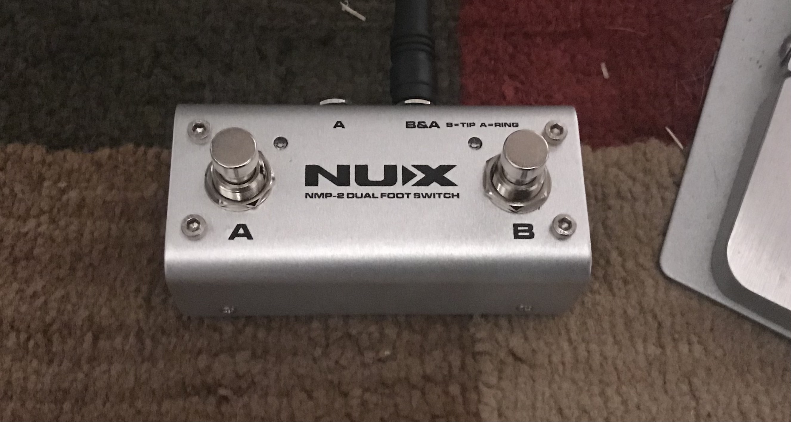

Picked up one of these for bank switching. It is working great.
