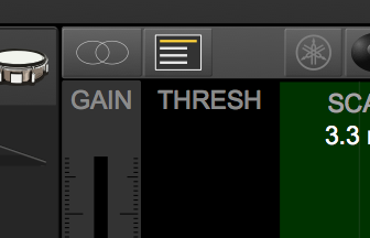

I'm just noticing some minor cosmetic glitches, most notably the Gain and Thresh display randomly disappearing from the UI. (Without even having used the Calibration feature.)
Screen Shot 2020-09-28 at 4.53.15 PM.png (24.41 KiB) Viewed 2210 times
