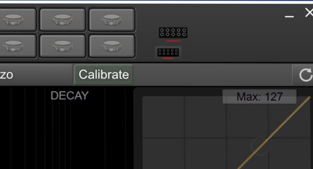

Mylo wrote:1. All I have connected to device A is my snare drum in input 1. It is set has a mesh center piezo pad. When I start the controller software the icon says it is a hi-hat.
The reason it's linked is because before installing 1.3, your 1st input had the 'Hihat xTalk' control enabled (which is now unused in version 1.3, BTW).
Mylo wrote:2. I changed device A to color red but the icon stays black.
Ya. Right now all ED10s use the same color of icon. I'll fix it. Thanks.
Mylo wrote:3. As stated above when I click on device B I can’t bring up the firmware page to change the color of the device or to update the firmware.
That's intended behavior. Changing the color would not be a problem, but updating the firmware from the USB host port is not supported at the moment. I should be able to make changes to allow changing the color, but don't expect to be able to update the firmware over the host port, at least not in the near future.
I think I follow you on issue 1. But this was straight out of the box. I hooked it up, upgraded the firmware, connected my snare and calibrated.
Based on your response though I went to the pedal inputs in both devices and reset them, reset my snare as well and started over. Everything seems good to go now.
Also... when I select my second device the red line stays on under both devices... this is kind of confusing. I’m not confident which device I’m working on.
I actually preferred the side by side approach you used before... I assume this layout is suggesting the smaller second icon is to inform me it is hosted by the bigger icon? I’m using a 13.1” touchscreen and I also remote into my machine from my iPad... the smaller icons are getting hard to hit with my big finger. :D

I hear you on the icons, but the side to side approach is for devices connected to separate USB ports.
Connect your two ED10s to separate ports and then plug an ED4 into each of the ED10s and you will see why it is the way it is.
Down the road closer to a version 2, I'll do a UI overhaul so that it isn't so awkward. I just didn't anticipate that would have a USB host port from day one.
