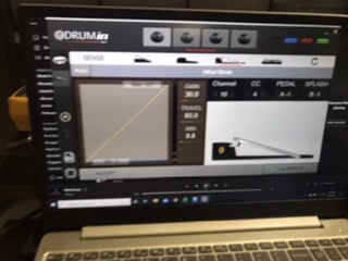

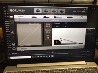

There is just too much room for error here. If you don’t realize the pedals aren’t changing automatically you may end updating the wrong pedal. I’m not sure I’m explaining this well. So I added some pictures.
What it looks like after I hit Blue device hi-hat. Pedal editor is not setup properly. I have to click the pedal button.
After hitting the pedal button.

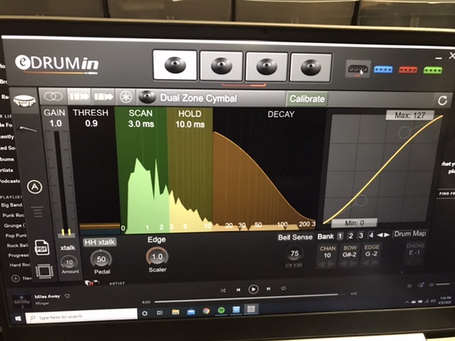

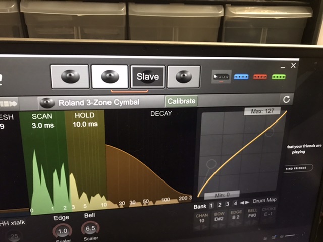

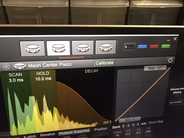

Possible UI bug... Version 1.1.0.9
My Black device has a 3 zone ride setup as a Roland 3 Zone Cymbal and the red line never goes away no matter which device I click on. In fact as I click on my devices in the UI the pads sometimes don’t update to correspond to the correct pads.
Black device has 3 zone cymbal
Black device selected after other devices selected but pads not updated
Green device doesn’t have a 3 zone cymbal but red line still there
