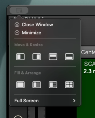

Might have found a bug in the minimize button, haven't seen this before, and it wasn't like this at first...
Screenshot 2025-03-28 233320.png (67.76 KiB) Viewed 3687 times
Screenshot 2025-03-28 233331.png (91.68 KiB) Viewed 3687 times
