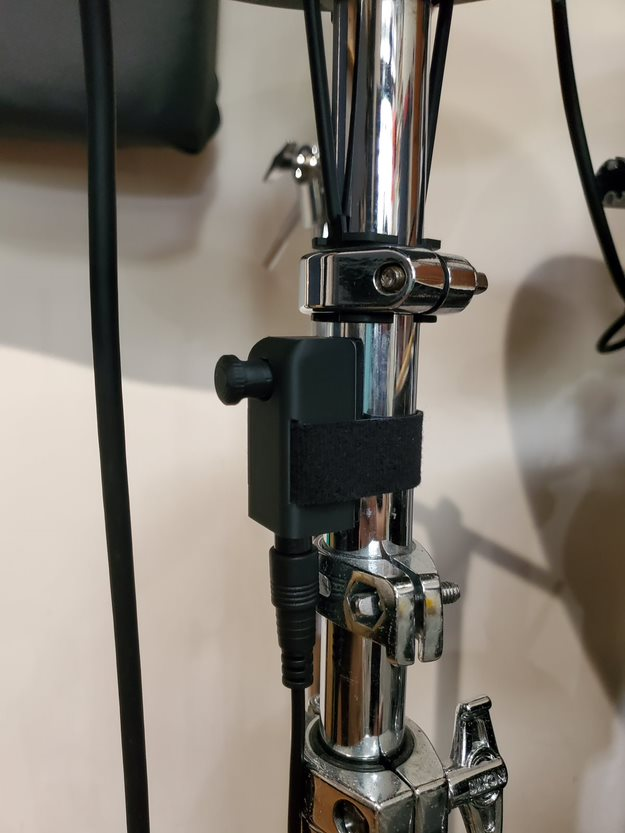

With a rotary encoder, you can select note banks, load flash snapshots, or send control / program changes. I have made a small batch of encoders which can be purchased here. I also made another small batch of Hall sensors that can be purchased from the same location.
Here's a pic of an encoder mounted on my hihat stand. I use four of them in total. Three are going into a MIDI Expression quattro to adjust the headphone, microphone, and instrument gain levels for my RME Babyface. The forth is plugged into an ED8 and I use it to adjust the kit piece setting one of my pads.
