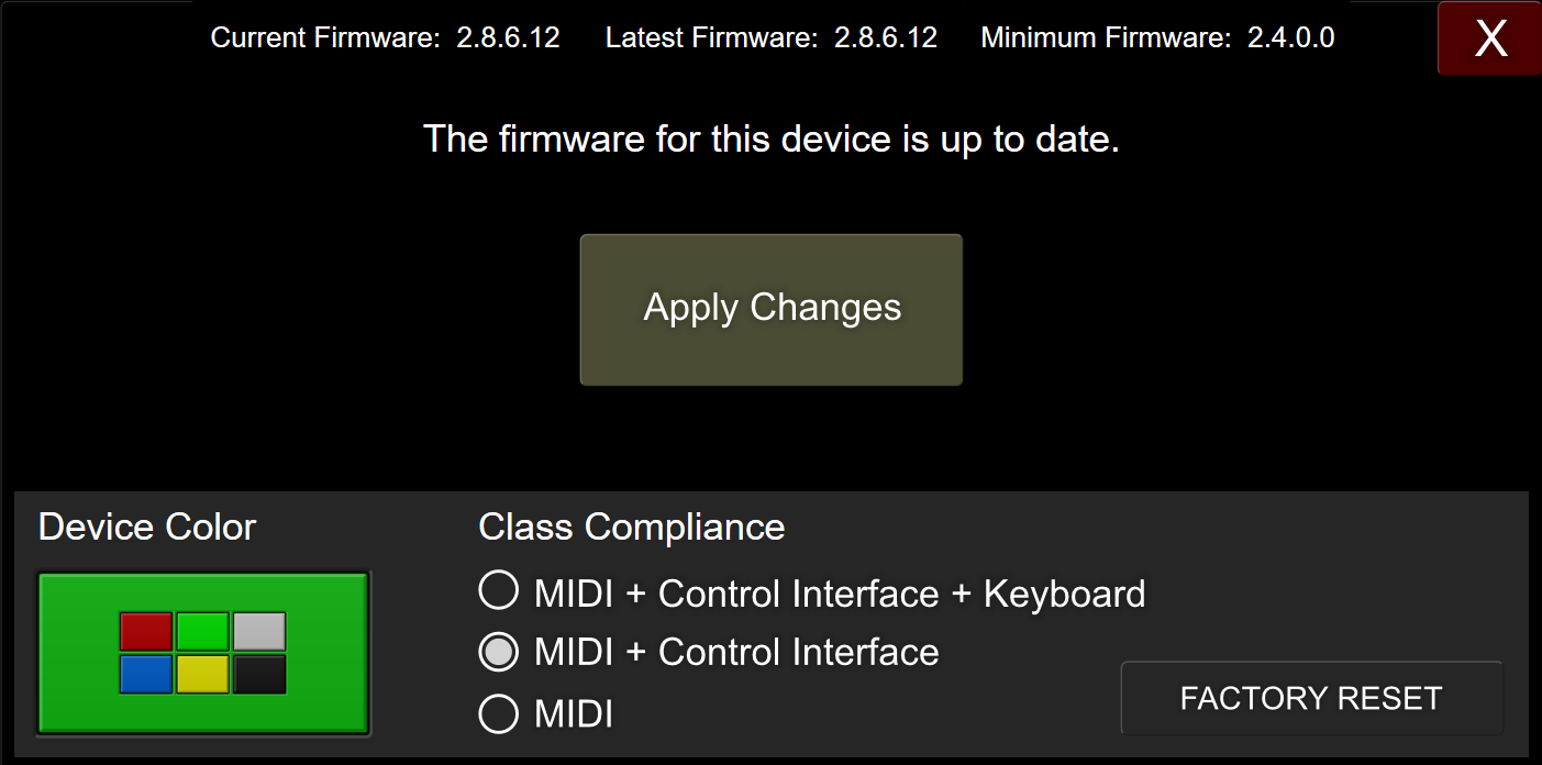

Re: MIDI Expression App not working
Version 2.8.6.13 (firmware version 2.8.6.12) includes a firmware fix for connecting with the iOS Control Application. Note that it's still advised to change the class compliant of your MIDI Expression to 'MIDI+Control Interface", otherwise you will run into issues if you are using iOS 14+.
