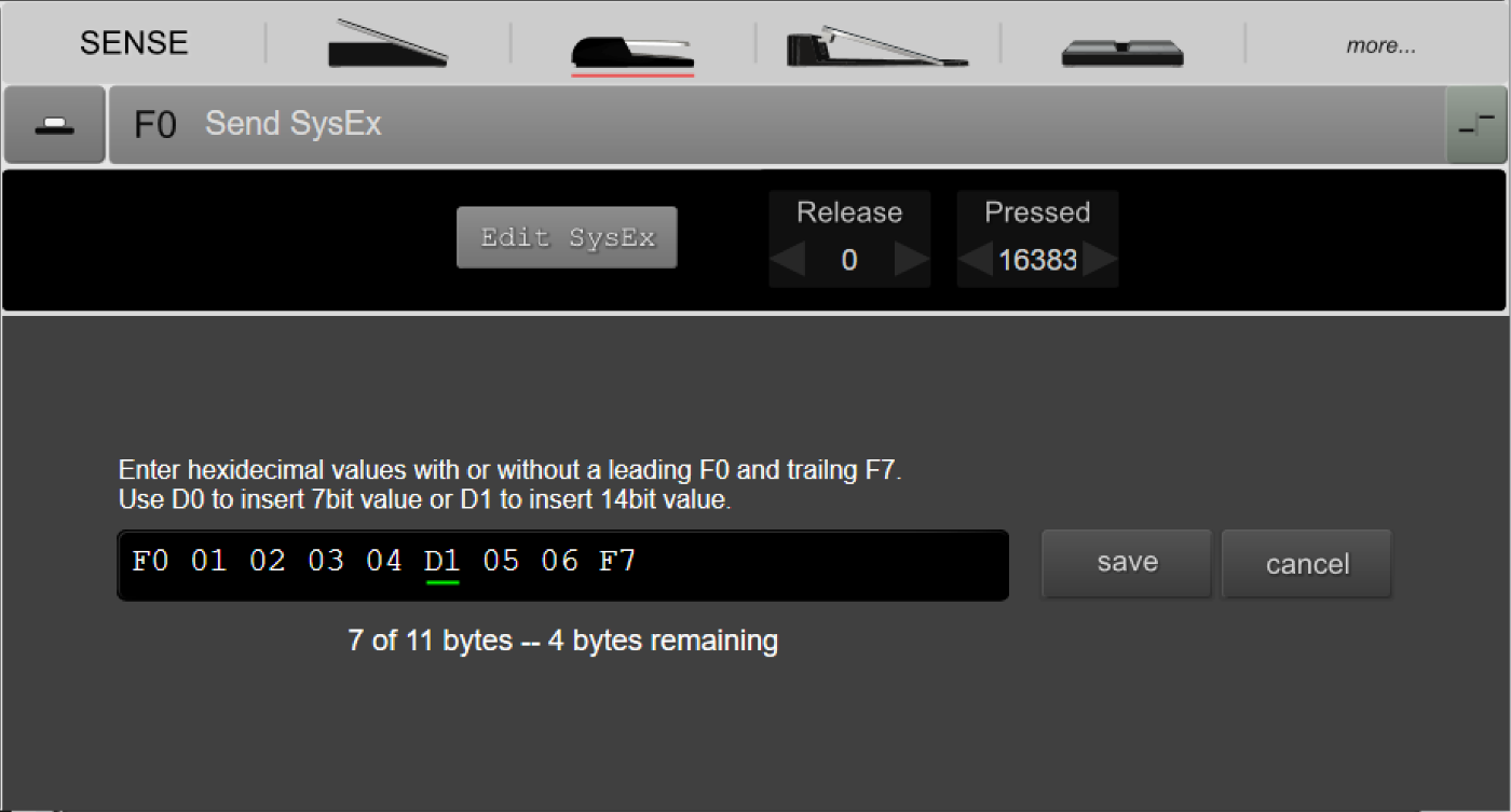

  • 7bit or 14bit parameter values can be inserted into sysEx messages and all pedal types can now send them.
