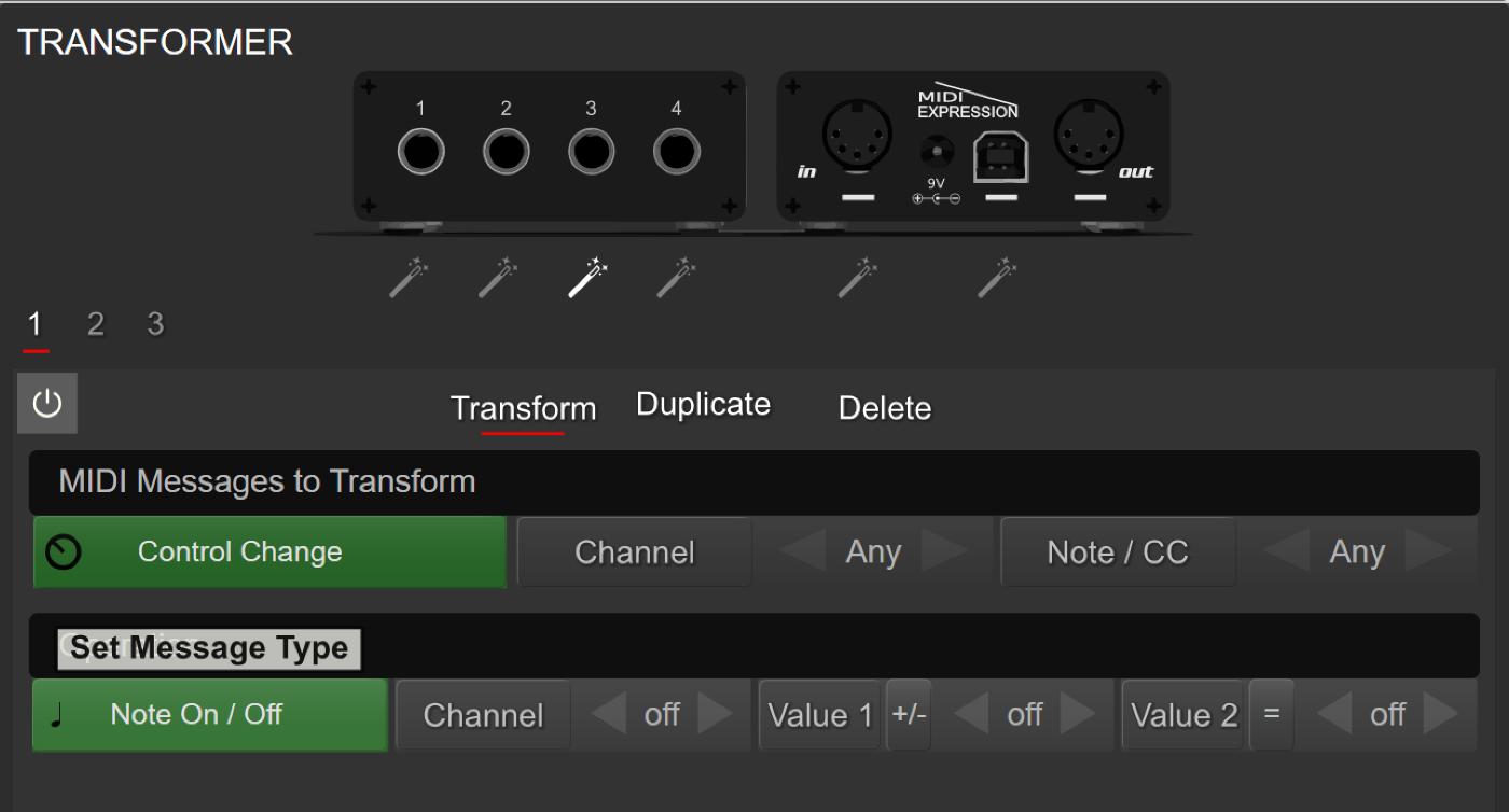

  • MIDI Transformer can now transform MIDI message types.
  • Transforming note velocity can now be set to +/-.
